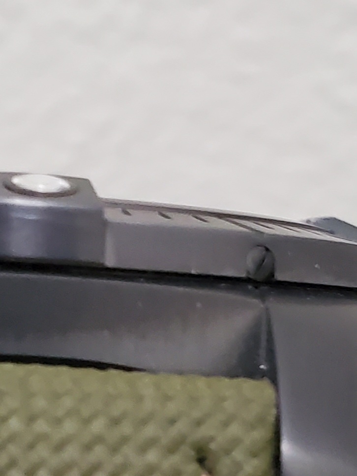

I currently own several Breitling Avengers and they all have the small etched
"B" on the outside of the bezel at the 11:57 position. I recently purchased a new Avenger Chrono 45 Night Mission DLC from an authorized Breitling dealer, model V13317. I noticed that this model doesn't have the etched B on the side of the bezel. I have 2 other DLC Avengers and they have the etched B. The watch is registered with Breitling and warranty valid until 12/15/28.
Is this a manufacturing flaw? I called the dealer and they couldn't explain the omitted B on the bezel. Any thoughts on this or how should I proceed?
Thanks in advance. Attached are pics of 2 watches with the B and the new watch without the B.
It's not a manufacturing flow, it was made on older model to differentiate between functional screws on the bezel from decorative screws. This screw change was made during production to ease SAV reparations.
The B was added for SAV reasons so that they don't try to pull on the bezel with functional screws (because the bezel without these functional screws was removed by pulling on it).
This B was kept for a few years even with new models with only functional screws.
However, it has been removed on the new ones (functional screws) for cost reasons and because it's not needed anymore.

Thanks for the follow-up. Appreciate it, now I don't have to worry about it!
