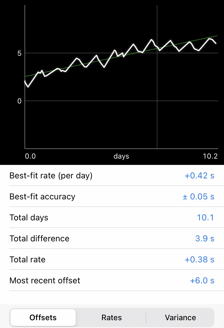

Posts: 6,765
So I basically ended my first tracking run a couple of days ago but thought I'd post the results. Seems to be working quite well! Now I think I'll try doing an every-other-day run of both of my watches alternated.
dannyp is offline   Reply With Quote

Two timing runs for my new 124270 FWIW.
stevecv is offline   Reply With Quote
