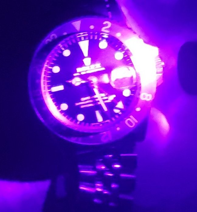

Name:  Screenshot 2025-05-0..._imresizer.jpg

Hi Dan, I attached some photos I think after you posted, to be clear, the dial and hands react in terms of looking brighter under the blacklight/uv, but neither continue to glow at all once no longer being under the uv light. Hope that's helpful. And they look nearly the same color to the naked eye, maybe the hands are a shade lighter in some angles, but mostly look very well matched.

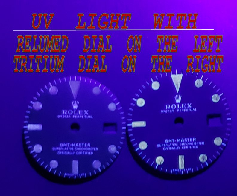

Dave, the dial is referred to as a Mark 5b which is slightly different than the Mark V GMT 1675 variation.
Also, I'm not sure what type of UV light you used for the photo, but normally the markers and hands have a much whiter glow under UV.
Here are some examples. The first photo is a GMT 16750 tritium dial with relumed hands. The second photo is a GMT with full tritium hands and dial. The third photo is a Mark II matte tritium dial. The fourth photo is a comparison between a relumed GMT dial and a tritium GMT both being examined under the UV light.
Thanks for the extra detail Springer, cool to know its a 5B! As for the UV light, in the real world they light up almost a light green, like your final example photo on the right, the hands are also bright but a bit more white. In my photo I think the iPhone automatically like normalized something so it doesn't look very bright.

UV light can vary in intensity/brightness, which can affect how the tritium appears in photos.
Still, I don't love how the OP's dial appears under the UV and would want a closer look to determine if the dial/hands have been relumed.

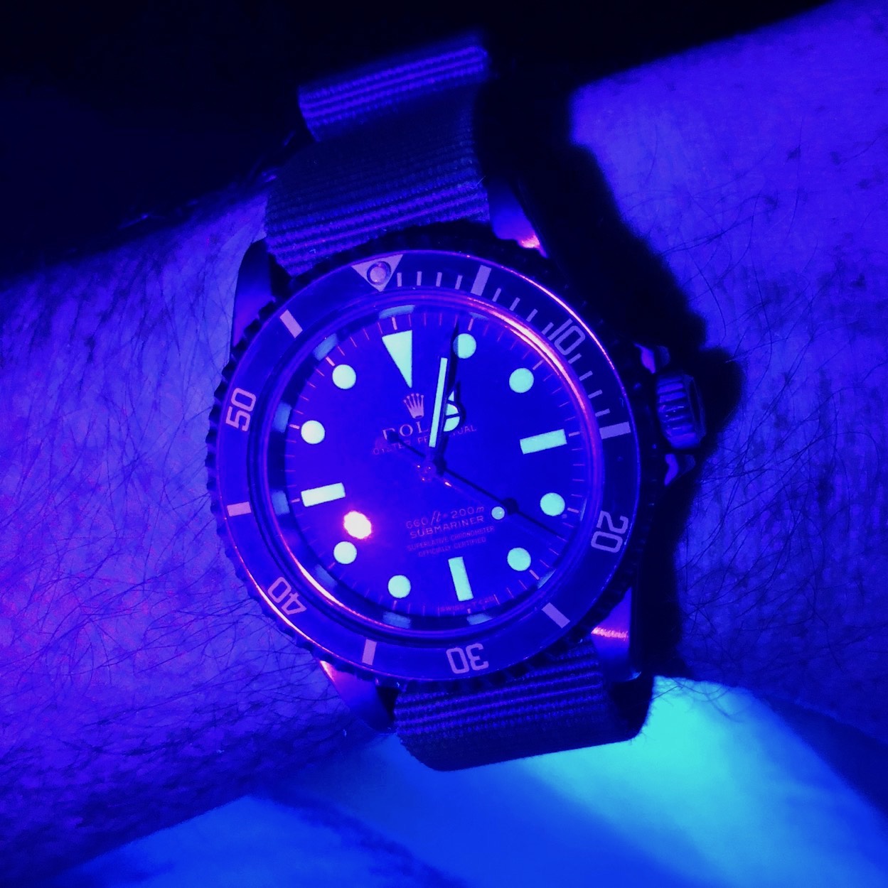

As Springer notes, original tritium usually has a whiter appearance under UV, as in this photo of my 5512 (3.7 million).
swish77 is offline   Reply With Quote
Yeah in real life they glow closer to this, my photo is just terrible
