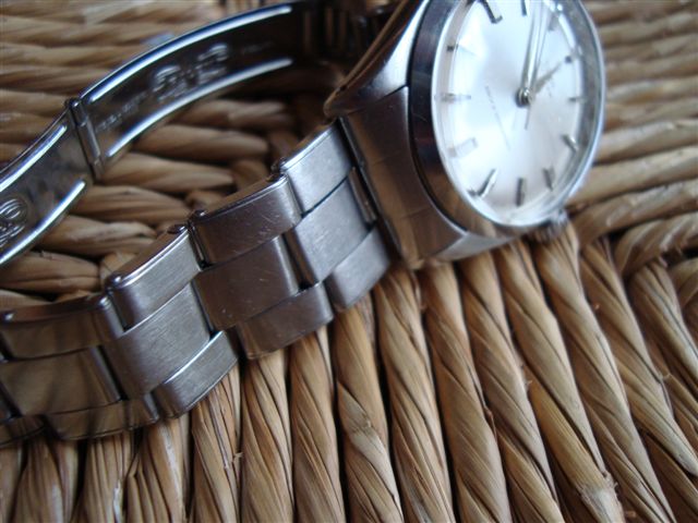

Hi Tylden
I finally found a link to replace the missing one.
The parts inside the links seem to be made of white plastic, instead of metal.
Is this a replacement part ?
Appart from that, the added link looks very much like the others.
I still have to fold it properly but have a spare one to make some experiment.

I just thought that the links I bought were formerly of the expending type and that the Z springs had been replaced by a piece of plastic.
On my own bracelet from 1964 you can clearly see the metal parts from the inside.
I'll have the all thing ultrasonic cleaned and will report again.
I don't especialy want to dismantle the spare link as it could be usefull in the future.

Well, the white part inside is really a piece of plastic which has been inserted.
I have done my best though the result does not really fulfill my expectations.
At least, can I wear this bracelet again.
Thanks for your help.
