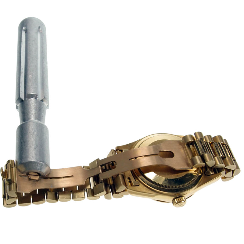

To be done correct and not leave any marks on the clasp, there is a special tool, it is a pair of handles that slip over the clasp from both sides at the catch, then apply pressure to spread the tabs of the catch apart.

here is the tool 75 dollars on the bay

Thats a interesting tool David, I would have thought you just needed to spread the wing clasps out a little bit. How does that spreader work? Is it just used to do a downward bend to get the wing to flex outward a little bit? I looked all over the internet at that tool and couldnt find any other pictures than the one you linked to via Ebay. Is it just a slot in that handle or is there something else on the bottom part of the handle/tool?

Thank you for posting this tool. I was able to correct mine based on the same principle. THANK YOU again!!!!

Nic, with that tool you can do the same amount of damage as with two flat pliers... Even though I do not recommend trying this at home, it is very simple, but also very delicate.
The tightening goes like this: You put the pliers on each side of the raised part on the clasp. VERY GENTLY you bent the surfaces down, away from you. Be very cautious not to snap the gold! The connection of the clasp with the bracelet is thin and fragile. A little bit too much pressure and your clasp will break, and can only be repaired by a (good) jeweler.
So, my recommendation is to go to a Rolex watchmaker and let them mess with it!

I used two flat nose pliers with masking tape on the jaws and did it myself.
Warmed up the clasp of my 18238 in hot water and used a little force to bend down both sides simultaneously. I exaggerated a bit and now it is very tight. Snaps in place with a satisfying click.
You don’t really need the tool imho

Thanks. Is the picture you attached of the tool?
Yes, these can be bought in a pair at Esslinger.com
Not all watchmakers know how to adjust these clasps properly. I’ve seen them trying to tighten up like you would with the newer clasp Has no effect on these type of clasps.
If you don’t want to DIY drop in at a RSC, it’ll take a minute only. Perhaps they are willing to help you out.
