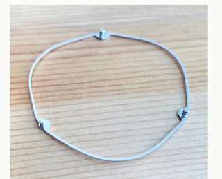

Hi everyone, just wanted to pick your brains. When putting a ceramic bezel back on a Rolex gmt is there a certain position the click spring has to locate to so the alignment is perfect. There’s 3 small location pins on the click spring that look evenly spaced plus 3 round locator holes on back of the bezel assembly , I would imagine that the it wouldn’t matter which pin located to which hole??

Here’s photos of the clicker spring, just seems to be slightly out of alignment when fitted, the triangle doesn’t line up with the 12 o clock

That fraction of a mm will make no difference to the function of the watch,and bezel is not supposed to be left permanently within a cat's whisker of the 12 o'clock marker.Got to ask why did you remove the bezel and insert in the first place.
