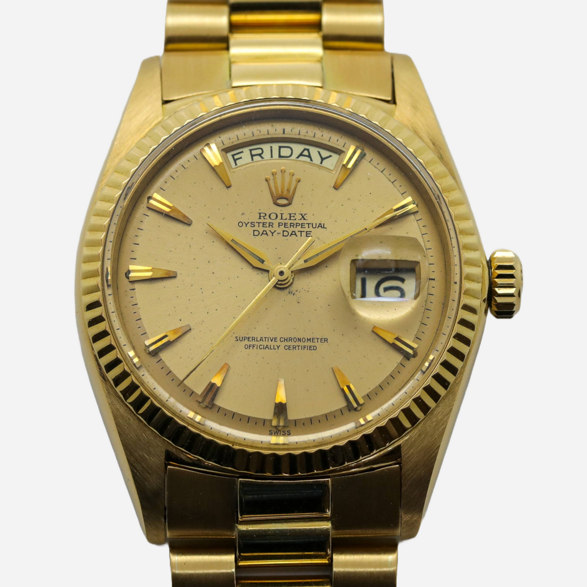

pie pan Day / Date bracelet - original or not?
I would like to hear from the Forum experts
Thank you in advance
Will likely sell and want to make certain I have facts

The bracelet is the least of its problems.
Even with the low resolution photos, the dial doesn't look authentic or is a refinished one.
If you have the watch in your possession, what is the serial number's first 4 digits and what are the codes stamped in the clasp?
That's important data.
This Day-Date is from the early 60's.
Rolex was using a different font at that time.
Dial appears to be original, but as mentioned photo is not clear.
Bracelet appears to be age appropriate.
MILGAUSS88 is offline   Reply With Quote

This is why I asked OP my questions.
That dial is no bueno IMHO here is the font for a 640xxx DD and the OP's photo of the watch is off quite a bit, don't you think?

The photo is still really bad. If you can't get a better one, you will have to determine for your self whether the dial is repainted. I am still seeing some weirdness on the minute tick marks at upper right, they seem to be painted over the dial step. Take a look for yourself.

I agree on the fonts being off on the OP’s watch and that is unfortunate.
Here’s an example of a claw day-date dial.
Big difference imo, but you could find a better dial OP if your watch is YG and not RG.
Not sure of the timeline the bracelet clasp should have the Helvetia or other location marking.
