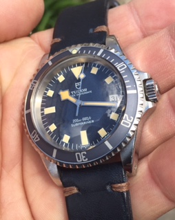

Team,
I would like to get everyone's opinion on this watch. This is a 7021/0 73X,XXX serial that comes with no papers and no bracelet.
I would like to get a bracelet for this watch and would like it to be correct to what the watch originally had. Can someone tell me please what bracelet and end links this watch should have?
Also I would like everyone's opinion on the watch. I know the 7021/0 had issues with the dials and "bubbles" but this one seems to be very clean. Also I would like everyone's opinion on insert, crown, case back, etc.
http://www.rolexforums.com/showthrea...ight=snowflake
really appreciate it.
regards
JFO

Endlinks are 280s or 380s. Band 7836, 9315 or more modern 78360, 93150. Stunning watch you linked

Hey bud! Good to see you here. It's nice looking watch but it has a domed crystal installed. But many like the dome look....

That's a beautiful looking SF. That said it looks black to me, even the insert looks faded grey. Could b my phone? 🤔

Great looking piece. Unsure if the dial has been changed or not as I have not seen many black 7021s with original dials to have a pulse on what should be there. That said, that is one of the nicest black 7021s I have seen.

Thanks for the info man. I am actually looking to see what the correct end links and bracelet should be for this particular watch any idea?

Yes buddy I am here too, though I rarely come in here anymore. The watch comes with both the domed crystal and the top hat which is the original for the watch!

I think it is an original blue dial. I have one that also looks nearly black (but mine has blisters). This looks to have been stored a long time but the insert is faded and the case has corrosion on the back so it was worn... Possibly only polished once in its life, just before pictures were taken
Good luck!

Its not your phone its the pics that were uploaded by the seller. Here are some better pics! what's your overall opinion of the watch?

pics above help? I am trying to see if someone can tell me a bit more about the watch just from pics. I think is a great example, but i did hear that 7021/0 dials had issues and wondering if someone can tell if this is a service dial or not.
what about the rest of the watch? Case, hands, crown, etc.

pieces is mine already bro! just looking for some opinions on the watch but more importantly what is the correct bracelet to get for this watch!
thanks!
