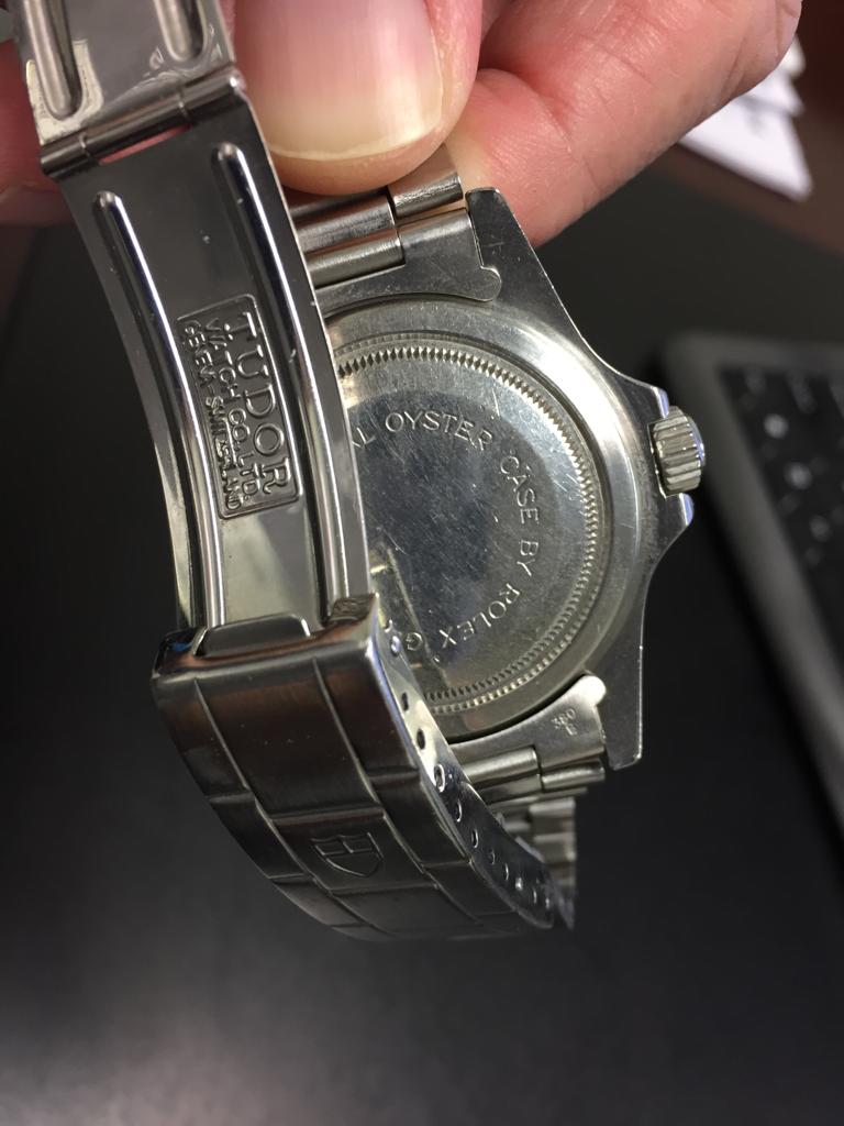

Can anyone recommend a case back opener for my Tudor Submariner?
Would something like this suffice?
https://www.ebay.com/itm/Watch-maker...Cpgi:rk:1:pf:0
This is the case back in question:

They aren't the best quality (I have one to open my cheapo "gardening" Parnis) but they are designed specifically for oyster cases, so pretty sure one of the dies will fit.
That back is llikely to be pretty tight though, so it would need careful use to avoid slipping.

This is a good choice.
https://www.esslinger.com/made-to-fi...xoC3-kQAvD_BwE
Provides a nice even pressure while you unscrew or screw on the back. Will need to be mounted to a bench though.

The LG Openall is a good one. Get the 4 post case holder (6.95) to fully protect your watch and if you buy the base (14.95) there is no need to attach it to the bench vice.
