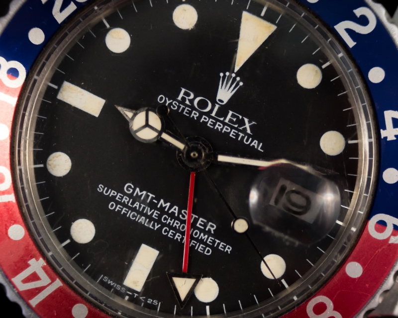

Which GMT 1675 dial is this?
I have read over the differences in dials, but am not really sure which dial is in my GMT Master 1675. Any experts want to enlighten me? Is there anything special about this dial or the Pepsi bezel insert? Thanks!

Latest production, Mk-6..

Posts: 59
My serial is a 2.59mil and the case back is stamped II.70. So, should I assume this to be a MK-6 service dial?

Posts: 6,713
Yes service dial not original to the watch...

Posts: 16,869
As watches became older, with service, the original production dials were no longer available so the later production dials (such as the Mk-5/6 or any of the known service dials) were put in place..

Posts: 59
THANKS folks. That's kinda what I thought, but wanted to be certain. The original dial to my watch would be... Mk I? Mk II? Mk III?

Posts: 6,713
It would be mark1 or mark2 dial originally.

Posts: 17,744
2.59 million serial should be a Mark I dial.

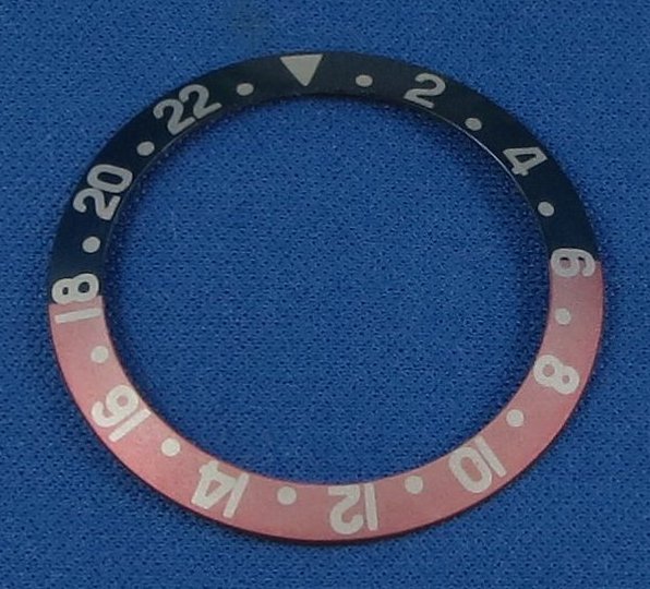

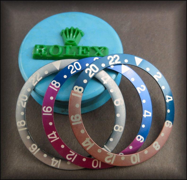

Originally Posted by WorldTyme View Post
I've seen a fat font on several bezel inserts for the GMT Master 1675. In fact, just found quite a few by doing a Google search - including photos on reputable info & dealer sites. However, I noticed only a couple that had the larger serifs.
So, it might be aftermarket. I'm not sure either. I acquired the watch around year 2000, so am not the original owner. Since we've established it has a service dial, the bezel insert might have been changed as well.
FWIW, back when I was actively collecting (late 1980's - 2003), these little things didn't matter much (as long as they weren't fake). Things like the all red 24 hour hand, the long "E", a "Bart Simpson" coronet were not even mentioned or "a thing" to any collector I knew back then.
It's funny how things change and little differences become big differences as time marches on.
Basically, I consider all 1675 original inserts to be fat fonts except for the super fat fonts. You might find some in the later 1970s that appear a little thinner, but not by much.
Super fat font below, and a combination photo with a fat font black, fat font fuchsia and the super fat font "Pepsi."

Old 16 February 2019, 08:39 AM   #17
1665fan
Join Date: Oct 2017
Real Name: Lucas
Location: East coast
Posts: 6,713
I would like see another super fat super serif insert.....besides the one in the OP
