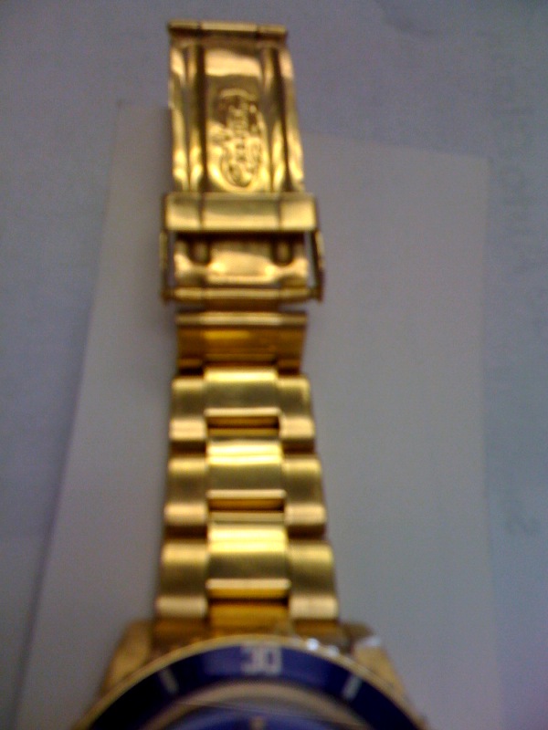

I took a (bad) cellphone pic here at the office. It is the pin that goes through the actual flip-lock mechanism. You can see that the pin has a slight "U" shape. It also is allowing the flip-lock to come off. So, I would imagine it needs to be peened?
Lesson Learned: Don't hit golf balls with watch on.

What generally happens is the rivet hogs out the whole on the foldover and no amount of peening will fix it. Depending on how big the wholes are best repair without replacing the fold over is clip the rivet on one end pull through have someone solder the holes and redrill to proper diameter and put a new rivet. The rivet is just a solid piece of gold wire and usually a good brass hammer will do the trick you would need a steel ball peen for the stainless rivet. It takes about 5 to 10 minutes of tap tap tap tap to round out the rivet head. Rikki
