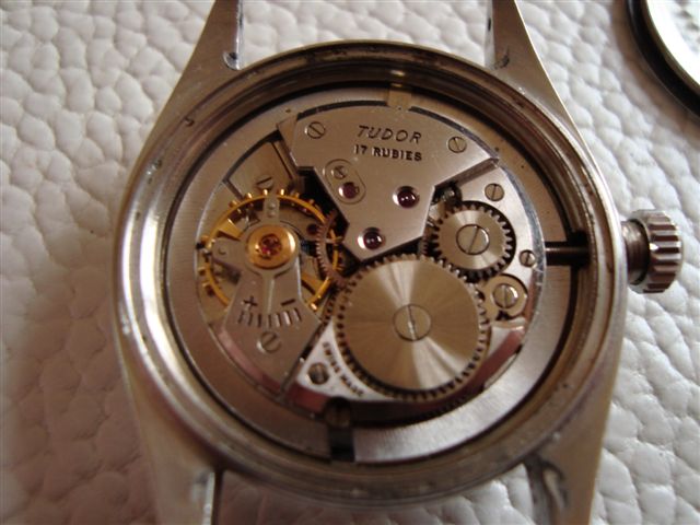

I just wanted to change the crown on my old watch but managed to turn that small screw too far to the left.
Is there a simple way to catch the nut again ? .

Usually when this happens the dial must be removed to gain access to the set lever(the part the small screw is attached to). With the dial off you can hold the set lever in place and screw the screw back into the set lever.

I have taken the dial off and understood how the set lever is fixed.
