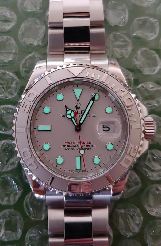

While I inherited (and wear daily) a mid-80s 16013, I just purchased my first "vintage" piece - an "A" series Yacht-Master 16622 - from an estate/auction house. Although it did not come with box/papers, it appears to have possibly been a safe-queen for most of its life.
Few questions:
  • What link-pin must I use to attach the eighth link to the clasp?
  • Am I only able to remove excess links from the anterior (non-clasp connected) bracelet?
  • The bezel arrow at noon seems ever-so-slightly off by a quarter-minute/second to the left. Any thoughts?

Nice pick up. The bezel is nothing to worry About. If you have the patience you can take it off and refit it a few times until you get it bang on TDC. I wouldn’t bother.

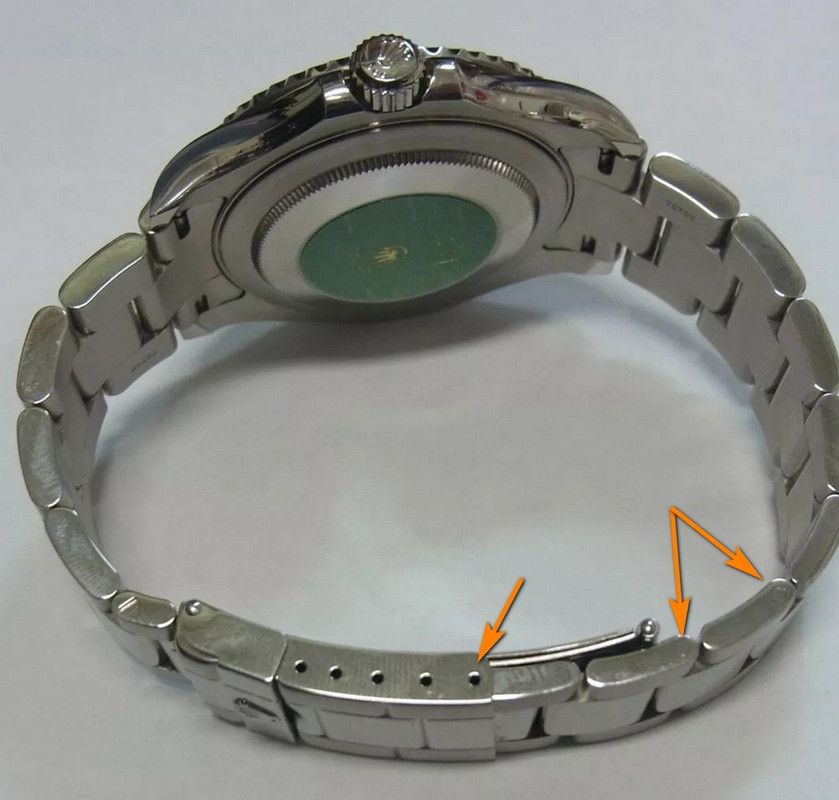

1) The links on A serials have screws, not pins. On the other side of the links, you should see the screwhead. You need a hollow-ground screwdriver 1.6-1.7mm, preferably the one made by Rolex themselves (ref. 2100). On the other side of the screwdriver, this tool has a pin-pusher to adjust your clasp as well. There are many look-alike tools from 3rd parties.
2) You can add and remove links from either side. Depending on your wrist, most people would size the watch so that the clasp sits in the middle (approx). It actually seems that the previous owner took out all removable links from 6 o'clock, so I would probably add the extra you have on that side. And then check how it fits and adjust accordingly.
3) The bezel on the 16622 is bidirectional and has 120 clicks. Could it be as simple a fix as just move it one click to the right? Otherwise take it to a professional. Given your questions, I would not attempt to remove the bezel and reattach it myself (no offense).
