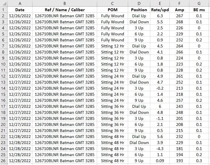

Data from my BLNR - it is actually running fast, which I did not expect.

Old 29 December 2022, 05:35 AM   #2
An observation I have seen in your 2 charts of today .......
Do you have two TimeGraphers ? You seem to be measuring two watches at the same time.
If you have just the one (Which is what I have) I can only measure one watch at a time as it stays all the time on the arm of my TimeGrapher. Moving the watch will inevitably cause some movement and therefore even add to your winding /Amplitude.
Regards,
CharlesN
Member of the IWJG.
CharlesN is offline   Reply With Quote

Posts: 6,242
Just one meter. The watches sit until the next reading cycle. I have a few to wear in the mean time. I’ll post a pic to demonstrate my setup, it’s pretty straightforward. So, there is a good 20-30 minutes difference in any given point of measurement period between the two watches. I read all five positions with each watch with a couple of minutes rest between each reading. I don’t really believe I am moving the timepiece enough to throw off the amp measurement and I believe the 20-30 minutes latency in 0, 12, 24, 48 between the two watches is pretty close to irrelevant.
Easy E is offline   Reply With Quote

Posts: 3,246
32xx movement problem poll and data thread
Something went wrong with your measurement in 9U @24 hours.
saxo3 is offline   Reply With Quote
