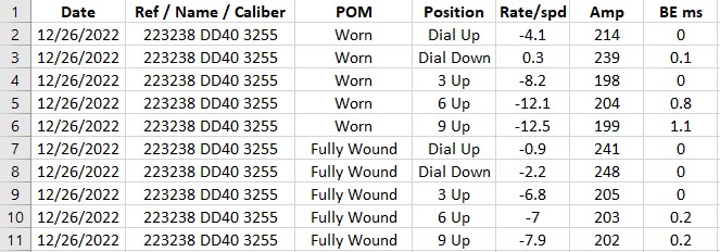

Pretty mad about this. A DD40 first round of data. I can not imagine that this is going to look good at all at 24 and 48hrs. Sheesh.

Originally Posted by Easy E View Post
Sheesh.
I have to ask ....
What lift angle have you set the Timegrapher to ?
I only ask this as your fully wound figures for amplitude are suprisingly low in all 5 positions.
Regards,
CharlesN

Originally Posted by charlesn View Post
i have to ask ....
What lift angle have you set the timegrapher to ?
53
Data from my DD40.
I have not understood the DD40 Results you posted for the first 5 readings ... Worn .... and then the 5 positions ..... Does this mean the you wore the watch for a period of time and then took measurements before the full wind and so on ?
Correct. Worn is random. Then full wind -> read, sit -> read, etc.
Easy E is offline   Reply With Quote
I almost joined you in the "Mad House".
Reading your figures (results) almost tipped me over the edge.
The only really good way to comprehend your figures is by showing them in a graph format.
Scared of tables? I understand. I’ll get them converted to graphs. May take a day or so, I’m going to be a bit busy at work the next day or so. More to follow.
